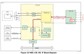

I understand that this is not the intended use of the BIST Functions Test, but is it possible to emulate the reception of data from a CSI camera using this function?
(*)Emulation here means that the CSI_RX_IF core can receive data by outputting a test pattern from the PPI interface of DPHY_RX.

    Our develop environment does not allow connection of camera devices. We need to debug the software in that environment.
    We expect the BIST function to act as a pseudo camera and behave as a image data source.
    I'm asking this question because I wasn't understand if DPHY_RX(cadence IP) can output the test patterns generated by the BIST function.
    I'm thinking that if DPHY_RX can output test patterns from the PPI interface, it can be used as a pseudo camera.
    If it is possible to operate as a pseudo-camera, we would like you to disclose the registers in the DPHY_RX module that are not open to the public.
    The following diagram shows the data flow I am expecting.
    data flow

    I did a quick internally with the experts and looks like  the DPHY_RX cannot output test patterns that you are looking for.
