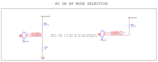

What we would like to achieve is boot TMDS64EVM through PCIe via J784s4. And for that we changed the TMDS64EVM DIP switches accordingly:
Additionally we do also select TMDS64EVM as an endpoint through jumper J34 and J35,
and R667/R668 where removed to avoid refclk contention on PCIe connector ,

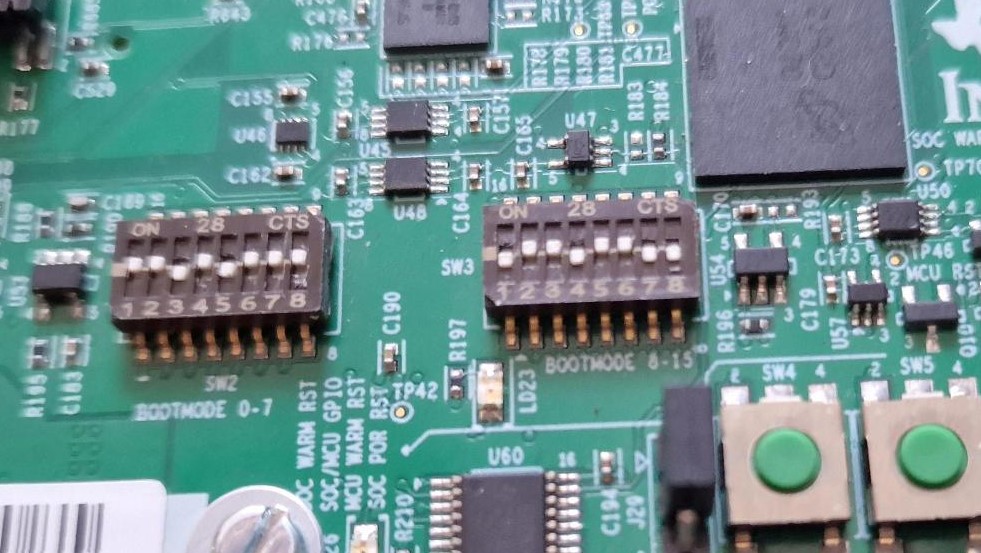

    The another thing that I can think of would the SYSBOOT switch settings, however since PCIe boot is not supported in Processor SDK, I won't be able to provide further comments.

    and my understanding is whenever the PCIe boot option is selected then "somehow" the device gets enumerated ("seen") on the bus. That should be a really low level behavior not depending (I supposed) on any software. So in the end the issue boils down to hardware... and even if there is no support of the boot process of this SoC on SDK, based on TRM we should be able enumerate the device.
    I do admit my understanding could be wrong, so in the end I would like to clarify if my understanding/expectation is reasonable.
