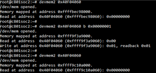

TDA4VM: SDK8.6 is unable to set registers on the linux side
Part Number: TDA4VM
The above is to set the register in SDK8.6, you can see that after setting and reading, the value does not change
The above is to set the register on SDK8.4, you can find the set after reading, the value can be set successfully
The above can cause in A72 device tree can't make pinmux function

  • yes , i trying this on j721e/tda4vm.
    I did not find any other peripherals in the device tree that use the AA24 terminal
    Is currently configured for spi3_cs0 reason is in "psdkra/pdk_jacinto_08_06_00_31 / packages/ti/board/SRC/j721e_evm/J721E_c801soc1_pinmux_data c" initialization AA24 for s pi

    We want to set AA24/AA28 muxmode to MCAN11_TX/MCAN11_RX
    We found that they were set in SBL:
    pdk_jacinto_08_06_00_31/packages/ti/board/src/j721e_evm/J721E_pinmux_data_info.c
    /* MySPI3 -> SPI3_CS0 -> AA24 */
        PIN_PRG0_PRU1_GPO7, PIN_MODE(4) | \
        ((PIN_PULL_DISABLE | PIN_INPUT_ENABLE) & (~PIN_PULL_DIRECTION))
    /* MyMCASP1 -> MCASP1_AFSX -> AA28 */
        PIN_PRG0_PRU1_GPO8, PIN_MODE(12) | \
    In SDK8.4, we can override muxmode as MCAN in Linux dts
    But in SDK8.6, Muxmod cannot be overwritten in Linux dts.
    Using devmem2 also cannot modify pinmux.
    Is there any restriction in SDK 8.6? Such as Firewall.

  • Hi Keerthy
    I tried to write another pinmux register: V27, it also failed.
    we found CTRLMMR_MCU_SPI1_CTRL will also fail to write
    and can_boot_app_mcu_rtos(run on MCU1_0) writing this register will also failed.
