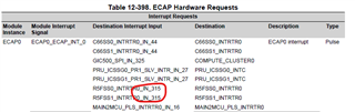

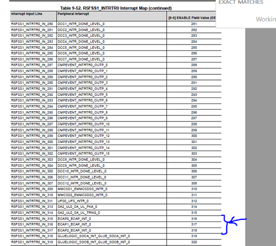

    Also I have a technical reference manual called "spruill 1c.pdf".
    As shown in the red circle below, ecap0's dst input index is 315~317, but the index of the FAQ link is 316~318.
    2. Which of the two is correct?
    The index mentioned in the FAQ is correct.
    Please find the same in the TRM as shown below

  • thank you.
    I confirm that my TRM is the same.
    so, i have try the dst_id, 316. but, The error still occurs.
    is there anything else needs to modified?
