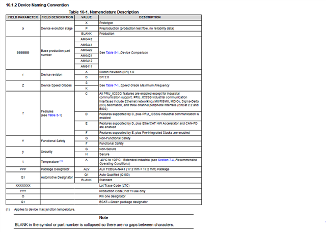

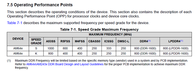

I want to know that the difference between AM6411BKCGHAALV and AM6411BSCGHAALV.
Hello Inho Jeon,
Thank you for the query.
K and S is the speed grade.
Please refer below.
