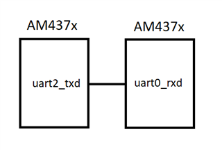

I could not find the issue of the Uart2_txd line; therefore, I decided to create a simple Uart project to test UART2 to make sure it is not about timing. The test was:
- I have one AM437x board running the Uart project test from FLASH which will send the command: "AM 12111111111111111111\r\n" to UART2_TXD Line
- I have the second AM437x board running the same project in DEBUG MODE (to set up breakpoints), and it will read the command from UART2_TXD at UART0_RXD
NOTE: Everything works fine in DEBUG MODE
- To make sure Uart2_TXD sends out the correct data, I checked using Docklight as:
- However, after connecting UART2_TXD toUART0_RXD and setting up a breakpoint, I can see the corrupted data packet as:
I could not think up any reasons behind the issue of UART2 when everything ran just fine in DEBUG MODE but not after FLASHED the device.
