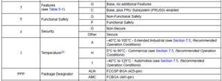

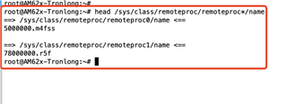

When using the AM6232ATCGGAALW , we cannot see the PRU core. It is possible to use the AM6254 chip on the official SK-AM62 development board. Does the AM6232 model now support the PRU function?
AM6232ATCGGAALW :
AM6254:

    If we reference the AM62x datasheet, section "Device Comparision", we see that all AM62x part numbers can have a PRUSS on them. There is no difference between AM623 and AM625. What IS different is the feature value of G (no PRU) vs C (contains PRU subsystem).
    Reference the AM62x datasheet, Device Comparison > PRUSS > NOTE (3):
    PRU Subsystem (PRUSS) is available when selecting an orderable part number that includes a Features code of C. Refer to Device
    Naming Convention for definition of feature codes.
    In Device Naming Convention, reference "Features" and "Package Designator"
    So if the features entry is G, then there is no PRUSS.
    Let's check for PRU references in the Linux devicetrees:
    ti-processor-sdk-linux-am62xx-evm-09.00.00.03/board-support/ti-linux-kernel/arch/arm64/boot/dts/ti$ grep -r --include=k3-am62* pru

    And if I check the datasheet, it does seem like all AMC packages have a feature entry of G. So that comment makes sense.
    Your part number has a feature code of C, so it should have a PRU subsystem. Please verify that your Linux devicetree is properly enabling the PRU subsystem.
