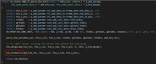

Now I am doing some work about parsing H3A data to optimize and develop our AE AWB and multi-gamma algorithms. But I am confused about how to parse the H3A data from VISS node according to codes marked in red in "vx_aewb_target.c", as the following figures show:
After I calculate the value of "p_h3a[k].red/ green/ blue" which also mean H3A data after normalized,  the value range is [0, 68], in stead of [0, 255]. Because I think the accumulative sum of all pixels value in each window is stored as uint16_t, the maximum of data is 65535. In our using case, if the pix_in_pax is equal to 957 , the H3A range is equal to [0, 68] according to codes from function "h3a_normalize()" in "vx_aewb_target.c".
So could TI experts correct me if I am wrong?
Besides, I do not know what is the meaning of the following codes in function "parse_h3a_out" in  "vx_aewb_target.c".
 if ((cur_addr - h3a_buf) % 32 == 16)
            cur_addr += 16;

  • Hi Lu,
    You may refer to the TDA4 TRM for H3A details.
    Yes, the normalization will reduce the range if you have many pixels in a single window.
    For your own AE, you don't have to do the normalization and you may send to number of pixels to your AE as an input parameters.
    That is because of the H3A output data packaging.
    You may refer to TDA4 TRM for the details.

    According to what you said, the data range of average luminance of each window depends on the number of pixels in each window. So is that true that the data range is changing and it is exact to calculate AE results using accumulative sum of each window instead of average luminance of each window? And H3A data is 10 bits (max is 1023) and accumulative sum is 16 bits (max is 65535). So if we want to keep each h3a data is 10 bits, the max number of pixels in each window must be less than 64. But actually, it is hard to keep the number less than 64.
    I printed log to get the parameter "pix_in_pax", which is equal to 957 in our using case and the number of windows is 32 x 16. But to be honest, I do not know how to calculate to get "pix_in_pax".

  • Hi Lu,
    Please refer to TRM H3A section for details.
    Input to H3A is 10-bit pixels and H3A outputs are 16-bit sums after programmable down-shift.
    You may also decide how many pixels to add together in each window with programmable skipping.

    I read the codes and TRM according to what you said, but I think if we use the accumulative sum as luminance statistics for AE, the maximum is still 65535 stored in uint16_t and h3a data is 10 bits. So I think it also has the risk of overflow for the accumulative sum of all pixels with no skipping in each window. Could you please correct me if my thoughts are wrong?
    Besides, I find that the bit depth of luminance statistics in AE is 8 bit, and before AE the bit depth of h3a data is always 10 bits. I do not know which codes of SDK can implement this process.

  • Could you please correct me if my thoughts are wrong?
    Yes, there is a chance of overflow if there are too many bright pixels.
    I am not sure which "luminance statistics in AE" you are referring to.
    Anyway, 8-bit is the scale chosen at TI for AE code interface.
    For your own AE, you may choose your scale freely.
    I am not sure if understand this question correctly.
    H3A outputs sums after a down-shift in H/W (you can find details in TRM).
    S/W may scale or normalize H3A output before AE for simplicity.
    You are not subject to those limitations while designing your own AE.
