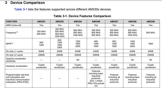

Hi team,
      I need to know whether the part no: AM3352BZCEA30 supports PRU-ICSS(EtherCAT, Profinet, Ethernet IP etc...) feature, because in the functional block diagram it is mentioned like this feature is present but if we check on the Device feature comparison, it is mentioned as not present.
