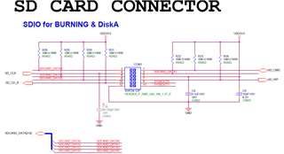

Thank you for all of your support. I am using AM625 on our board and I have a question regarding the mmc1(sdhci1).
I want to mount eMMC on mmc1(sdhci1).
Here is the situation I have met,
1. I'm able to successfully read from the SD card during u-boot and rootfs , but  eMMC is not able to detect.
2. When I short the SDCD pin to GND(pull low) , eMMC can be detected and read in rootfs.
3. Then I tried to modified the setting in the device tree of kernel & uboot, I failed. The eMMC can not be detect.
The modification is as follows,
1. add "on-removable;"
2. add "no-1-8-v;"
A lot of SDHCI register dumps logs getting printed continuously,

3.After that, I tried to remove "non-removable;" and add "gpios = <&main_gpio1 48 GPIO_ACTIVE_LOW>;"  and  the pin D17  set to the mode 7 as follow:
	main_mmc1_pins_default: main-mmc1-pins-default {
		pinctrl-single,pins = <
			AM62X_IOPAD(0x23c, PIN_INPUT, 0) /* (A21) MMC1_CMD */
			AM62X_IOPAD(0x234, PIN_INPUT, 0) /* (B22) MMC1_CLK */
			AM62X_IOPAD(0x230, PIN_INPUT, 0) /* (A22) MMC1_DAT0 */
			AM62X_IOPAD(0x22c, PIN_INPUT, 0) /* (B21) MMC1_DAT1 */
			AM62X_IOPAD(0x228, PIN_INPUT, 0) /* (C21) MMC1_DAT2 */
			AM62X_IOPAD(0x224, PIN_INPUT, 0) /* (D22) MMC1_DAT3 */
			AM62X_IOPAD(0x240, PIN_INPUT, 7) /* (D17) MMC1_SDCD */
But now SD card is not able to get in uboot as follow,
U-Boot SPL 2021.01-ge7c2703b4a (Sep 12 2023 - 09:48:45 +0000)
SYSFW ABI: 3.1 (firmware rev 0x0008 '8.6.4--v08.06.04 (Chill Capybar')
Trying to boot from MMC2
spl: mmc init failed with error: -70
SPL: failed to boot from all boot devices
### ERROR ### Please RESET the board ###
I feel confused . Why is it not detecting the eMMC but SD card  can do that?
It seems to be related to SDCD pin detect problem.
How can I detect eMMC during uboot and  rootfs with correct setting?

  • Sorry for  the incorrect location of  the circuit picture  and  the wrong word "non-removable;" .

  • Hi Vincent,
    I didn't review the rest of your post after I see this message. I believe MMC1 only supports SD card and SDIO, not eMMC. Please see the AM625x Datasheet section 7.10.5.15.2 MMC1/MMC2 - SD/SDIO Interface for details.
  • Hi Bin,
    Thanks for your reply,
    Let me briefly explain our usage scenario. Initially, I used an SD card (connected to MMC1) to boot the system, and then the system was burned into the eMMC (mount on MMC0). After that
    , SD card slot (MMC1) was replaced with an external board (another eMMC).  Finally, the system was booted from the eMMC (MMC0) and eMMC(MMC1) became a storage device.
    Hence, there are totoally two eMMCs. (MMC0 for system, MMC1 for storage)
    I have a few questions:
    1. I know that MMC1 is designed for SD card, not eMMC .But it can't explain why I shorted the SDCD pin to GND(pull low) , eMMC can be detected.
    2. Would it be possible to modify the MMC1 driver or device tree to detect eMMC without pull-low CD pin ?
    I  tried to log the kmsg , when MMC1 connected the eMMC and SD card (use command: cat /proc/kmsg).
    Here's the relevant log,
