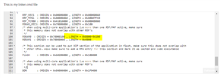

This is my linker.cmd file

  • Hi Ahmet,
    Looks like MSRAM0 does not have enough memory to fit debug image file
    1. Why customer allocating such a less space for MSRAM0 ?
    2. Can we suggest to run with default settings in SDK example
    Best Regards
    Ashwani
  • Hi
    Thanks for your reply.
    I think there was a mistake when I shared the linker.cmd file.
    Actually, my project's msram settings are as follows.
        MSRAM0	: ORIGIN = 0x70000100 , LENGTH = 0x80000-0x100
        MSRAM1  : ORIGIN = 0x70080000 , LENGTH = 0x40000
    Thanks..

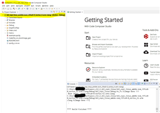

  • Hi Ahmet,
    To reproduce the issue on my setup.
    1. I opened "C:\ti\mcu_plus_sdk_am64x_08_05_00_24\examples\drivers\boot\sbl_ospi_linux\am64x-evm\r5fss0-0_nortos" in ccs
    2. By default build mode was debug only.
    3. Right click on project and build.
    4. It is passing.
    • Can you try same thing on your setup?
    • If yes, what next step I need to follow ?
    • May I know your goal, what you want to achieve (end goal) ?
    One quick thing you can try is change in linker.cmd file as below:
    MSRAM0 : ORIGIN = 0x70000100 , LENGTH = 0xC0000-0x100
    MSRAM1 : ORIGIN = 0x700C0000 , LENGTH = 0x40000

    You should integrate enet_cpsw_rawhttpserver example into "C:\ti\mcu_plus_sdk_am64x_08_05_00_24\examples\drivers\boot\sbl_ospi_linux\am64x-evm\r5fss0-0_nortos" project. You must make syscfg settings for the enet module and add the necessary source and header files. As a result, you should be able to run Ethernet properly. I can say that this is my main purpose.

    So, please,
    1. Expand MSRAM0 length
    2. Shift MSRAM1
    3. Move R5_0_0 to R5F_0_1 MSRAM
    4. and let me know, if you get build successfully.
