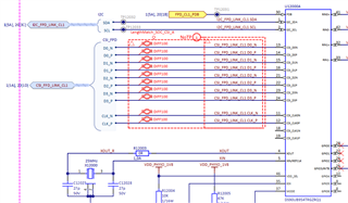

I'm now working with the vision_apps demo in our custom board. Here is our system config
Input:
Output:
I now having a issue about the display of the camera, there are no camera image displayed and it seems that the camera data still not available.
I've compared the log of TI devkit and our source code and found this one. It seems that the RAM usage is quite low, I suspect that there are still no camera data here.
Could you please help share where I can check with this status.

    I'm using the camera UB953 and the deserial is UB954.

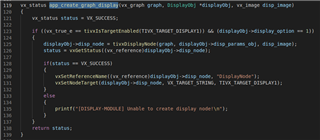

    I'd like to update some information.
    It seems that there was some errors during initialize the camera sensors. So I remove others, only keep IMX490 which is being use in my project.
    And the FPS look fine now, but there is still no image display on screen.
    Could you please help check the log here and guide me some ideas to check:

    The multi-cam application in the SDK has the display node integrated.
     You could refer to the APIs such as app_init_display(), app_create_display() etc which is used in the multi-cam demo, which adds the display node to the graph.
    You would have to point the processed capture image to the display image and make use of the above APIs above to integrate display node into the graph.
    Nikhil

    I think I can understand the app_init_display() as this function will init some of the initialize params for the display. I think this function is OK.
    But about the app_create_graph() & app_create_graph_display(), it is quite complicate and I not really sure about it logic.
    So could you please give me more details about this?
    Here is some of my concerns:
    1. I see that there is definition about "TIVX_TARGET_DISPLAY1". Please help me clarify this definition.
    2. These APIs, may I know what does it do? Is it control the DSI or something?
    3. In my cases, I use the GMSL instead of UB941. So could you help check and show me the relationship between these API with the operation of UB941, how they work together?
    4.
    Could you help show me the methods in vision_apps that do this with DSI (UB941) display? In my scenario, I have direct connection from the UB954 to the SOC CSI so not really sure how about the software configuration in this case.
    Thank you very much.
    This is basically a task on which the DSS display node would run on the R5 core
    These APIs add Display node to your graph and Display node controls the DSS driver which puts the data onto DSI.
    Display node places the data onto DSI and as long as GMSL is configured and DSI is selected as output during initialization, there need not be any other changes from the node perspective.
    Nikhil

    Did you add the display APIs now before enabling the debug logs or was it already there before and you had not included it in the graph?
    These APIs I see it's already implemented in vision_apps/modules/app_display_module.c
    I'm now trying to add more debug log to see if there are any errors or mismatch for those APIs.
    Are there any suggestion from you to check in these APIs?
    So can I understand these APIs will control the DSS driver and without this controller, the DSS cannot put the data onto DSI?
    Thank you.
    Yes, they are already implemented APIs and they are being used in the multi-cam demo application in the SDK.
    I'm confused here. Did you add the display APIs now before enabling the debug logs or was it already there before and you had not included it in the graph?
    My doubt was whether you had this API in your application before or are you adding these API to your application now?
    Yes, These APIs create the display node and without this node, the data cannot be put onto DSI.
    Nikhil
    I've put some logs and found that in the APIs app_create_graph_display the value of displayObj->display_option = 0. That is because my app_multi_cam.cfg config the value display_option = 0.
    So may I ask, follow the comment in the app_multi_cam.cfg
    So when I change to use DSI, I change the value to 0.
    But in my case, I'm using the DSI, so does this config take any effect? Or just the comment here missed some information?
    And after update the value of display_option = 1. I can see the display node present. But there are still no image displayed.
