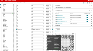

For my needs, i need to change the kernel, device tre, to enable a pin on my SK-AM62A-LP eval board.
I used the online tool sysconfig. This tool give me 3 files :
AM62A_pinmux.h
AM62A_pinmux_data.c
devicetree.dtsi

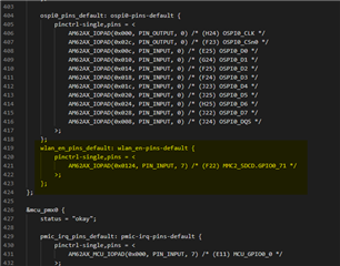

Then, i went to <sdk_path>/board-support/linux..../arch/arm64/boot/dts/ti
open the file k3-am62a7-sk.dts and add this to &main_pmx0 {
    mymmc21_pins_default: mymmc21-pins-default {
        pinctrl-single,pins = <
            AM62AX_IOPAD(0x0124, PIN_OUTPUT, 0) /* (F22) MMC2_SDCD */
