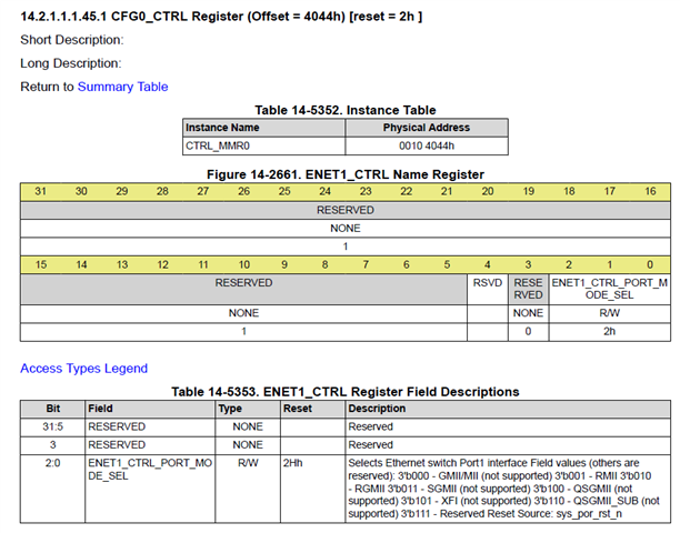

Hello Experts,
My customer is building their own board. They have two questions about RGMII.
(1) Is it necessary to control impedance at a single 50 ohm for each RGMII line?
(there is no description of RGMII in High-Speed Interface Layout Guidelines.)
(2) Could you please tell us what the RGMII mode (TXC, RXC Delay setting) and Delay values are by SDK default for SK-AM62A-LP?
Ken
