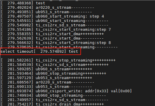

When I was debugging my camera driver(the pipeline: ar0220AT & ub953 & ub960), I executed the following command
v4l2-ctl -d /dev/video8——set-fmt-video=width=1820,height=940,pixelformat=RGGB——stream-mmap=3——stream-skip=4——stream-to=/home/root/ar0220/test.bin——stream-count=1——stream-poll
But a select timeout error occurred. Which module is the problem and how to solve it?
And if not add the stream-poll option, it will get stuck in the dqbuf.
I added a new camera driver and enabled the corresponding device tree in boot, such as vision_app, fpdlink_fusion, sensor.
I can now confirm that the frame count for the camera and deserializer (ub960) is increasing. But the program will stay stuck in dqbuf.
I'm wondering what should I do to debug.
Do you have any idea?

  • Hi Jaimes,
        The sdk I use is sdk-8.6-vh.
    I'd like to update you on something new.
    When I enabled tpg for the serializer ub953, it worked fine with the default tpg configuration. But when I change the format to raw12, the same problem occurs.
  • Hi Zheng,
    Could you share me the device configuration using the media-ctl?
    I believe you are trying to stream a single channel right?
    Have you configured the format to RGGB in the ser and des using media-ctl?
    Nikhil
    Thanks for your nice help. So far I've learned the format I need to configured to BA12 with your help. The problem has now been solved.
    The reason for asking this question is to know if the TDA4-VH board supports my camera (AR0220AT, format: bayer_grbg12). So far I have been able to successfully obtain the image through the V4L2 command.

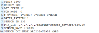

    I'm working on AR0220. But I need to configure the sensor name to SENSOR_ONSEMI_AR0233_UB953_MARS for it to work properly. Or I'll get a 'Invalid sensor name' error.
    With your nice help, now I have created DCC files which support the resolution I need. But the video is gray.
    This is config file.
    The command I use is as below.
    gst-launch-1.0 v4l2src device=/dev/video8 ! queue leaky=2 ! video/x-bayer,width=1800,height=920,format=grbg12 ! tiovxisp sink_0::device=/dev/v4l-subdev7 sensor-name=SENSOR_ONSEMI_AR0233_UB953_MARS dcc-isp-file=/opt/imaging/ar0220/dcc_viss.bin sink_0::dcc-2a-file=/opt/imaging/ar0220/dcc_2a.bin format-msb=11 ! video/x-raw, format=NV12 ! tiovxldc dcc-file=/opt/imaging/ar0220/dcc_ldc.bin sensor-name=SENSOR_ONSEMI_AR0233_UB953_MARS ! video/x-raw, format=NV12, width=1800, height=920 ! kmssink sync=false driver-name=tidss
    Do you have any idea on this issue?
    Zheng
  • But the video is gray.
    Hi Zheng,
    I suppose you mean the output image is black and white (monochrome).
    I believe you would always get gray output if you use the python code before SDK 8.6.
    Could you confirm if you use the latest python code on git -- https://git.ti.com/cgit/processor-sdk/imaging/tree/tools/default_DCC_profile_gen?h=main
    T
    hat should be the same as SDK 9.0 and you shall get color output.
