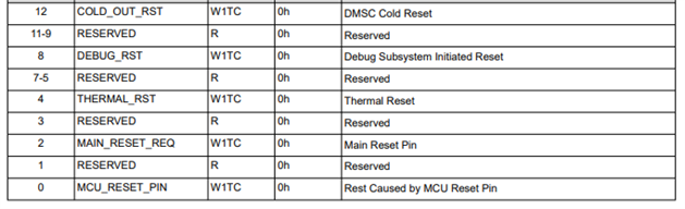

My customer is looking for a register to read at power on to determine if the most recent reset was caused by a Watchdog timeout.
I can see the CTRLMMR_RST_SRC (0x43018178) and CTRLMMR_MCU_RST_SRC (0x04518178) registers in the TRM but there is no bit that indicates a Watchdog reset.
Is there another register I should be checking?

    The customer would like to know during the boot process why/how the device was reset. Specifically, if the most recent recent was caused by a timeout of the WD timer.
    I can see the reset source registers (CTRLMMR_RST_SRC and CTRLMMR_MCU_RST_SRC) that are used for this purpose, but what I'm now unclear on, is which bit would be set after a WD timeout given the MCU ESM is handling it. Does this mean that the SAFETY_ERROR bit (bit 31) should be set? Or does the ESM cause a different type of reset?

    I webex'ed with the customer today and they confirmed that bits 30 and 31 are being set after the WD timeout on AM64x using Linux. So it appears that option #2 is being used with the Linux WD example.

    I looked at the above code, and it looks like they implemented it in the second method, and they are controlling the MCU_ESM_ERROR_RST_EN_Z bit, and I
    have not seen controlling SOC reset with the help of any MMR Registers after expired Watch Dog Time.
    So, monitoring 30 bits and 31 bits is the proper method.
