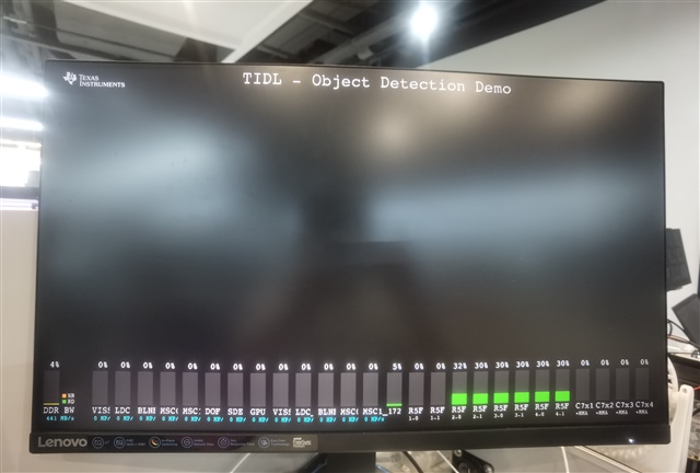

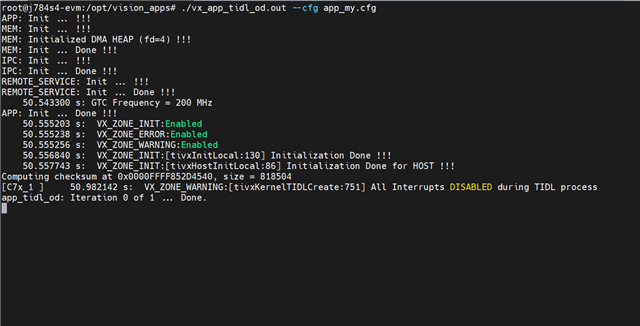

4) The routine used is vision_apps/dl_demos/app_tidl_od, the generated executable is VX_app_tidl_od.out, run VX_app_tidl_od.out on the EVM board -- Cfg app_my.cfg.
5) The log information obtained on SDK 8.2 is as follows, and the program will get stuck at this time:
The screen appears as follows:
Could you please help check this case? Thanks.
