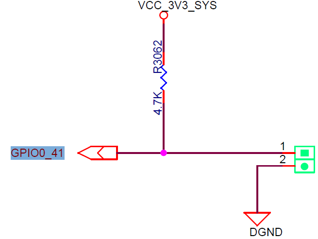

I want to read the value of gpio0_41 input pin in u-boot to determine the lvds-panel dtb to be set for name_overlays.
The default input of gpio0_41 should be high. When pin1 and pin2 touch, gpio0_41 will be grounded to low. And I've checked with an electric meter.
Below are my steps. Please help to confirm if there are any missing steps.
Please refer to \board-support\ti-u-boot\doc\usage\cmd\gpio.rst.
1.add CONFIG_CMD_GPIO=y and CONFIG_CMD_GPIO_READ=y to \board-support\ti-u-boot\configs\am62x_evm_a53_defconfig
2.Enter u-boot command line

=> setenv myvar 2
=> gpio read myvar 89
gpio: pin 89 (gpio 89) value is 0
=> printenv myvar
myvar=0
The above is the situation when entering u-boot for the first time. The value of gpio0_41 should be 1 but it is displayed as 0.
But if I enter the kernel, run reboot and then enter u-boot again, the value of gpio0_41 will be read correctly.

  • Hello Andrew,
    I noticed that pins other than GPIO0_41 have changed value from the logs you provided. These pins in GPIO0 (0x600000) have all changed from logic 0 to logic 1: 35,37,41,43,44,65,69,71, and 80.
    Can you share the changes you made to the device tree?
    Are you using custom hardware or TI EVM?
    Some of the GPIO pins share the same AWL ball number with other peripherals. Make sure that there is no conflicting pin mux settings in the device tree. Here is the link to the AM62x datasheet so it can be verified: https://www.ti.com/lit/ds/symlink/am625.pdf
    Anshu
  • Hi Anshu,
    Thanks for your reply.
    A similar situation occurred using "SK-AM62 EVM E3" and default code sd card.
    Please test it.
    1.use J3 pin37(EXP_GPIO0_41), J9 pin1(3.3V), J3 pin9(DGND).
    2.enter u-boot cmd line, run "gpio input 89", and see gpio value.
    Below are my test results:
      1.in first boot and enter u-boot cmd line:
        a.connect 3.3v show low.
        b.connect DGND show low.
        c. not connected show low.
      2.run reboot and enter u-boot cmd line:
        a.connect 3.3v show high.
        c. not connected show high, but measured with an electric meter is 0.2V.
    Andrew
  • Hi Andrew,
    I am currently trying to replicate your results.
    Can you explain why you are using 'gpio input'? Input does not seem the change the value according to the U-Boot Docs. Here is the link GPIO U-Boot docs: u-boot.readthedocs.io/.../gpio.html
    For the GPIO0_41 pin, has the device tree been modified so the kernel can recognize the pin? Since you said its using the default SD card, the default device tree doesn't not have those GPIO pins. I've noticed that without the device tree changes, there is a disconnect on the actual value where the software and hardware hold different values.
    The 3.3V could be getting setup which could explain why 3.3V is low on first boot and power has not been supplied to the pin yet.
    Try checking 3.3V after the boot and then check again after some time without a second reboot.
    Anshu
  • Hi Anshu,
    My task is to use the green jump in the picture to select the dts node corresponding to the lvds panel to be used by the kernel during the u-boot stage. Only one sd card image is used, but the optional screen can be selected before booting.
    I plan to get the value of GPIO0_41 pin in uEnv.txt to set name_overlays=target_lvds_panel.dtb.
    So I will add the following command to uEnv.txt.
    uenvcmd=setenv gpio0_41_value 1;gpio read gpio0_41_value 89;if test "$gpio0_41_value"="1"; then name_overlays=lvds_panel_a.dtb;else name_overlays=lvds_panel_b.dtb;fi
    Please tell me how to achieve it, or if there are other methods.
