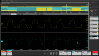

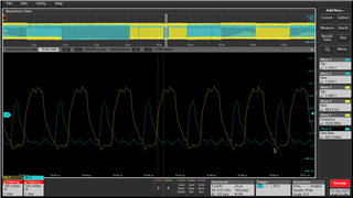

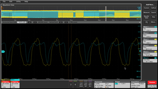

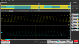

  • Hello Krunal,
    Thank you for the recommendation, we have checked the clock it's it's perfect.
    But nor sure about data, attaching some screenshot for the same.
    Frame rate required for display is 60.0Hz. And kmsprint command says it's configured as 65 Hz.
    Crtc 0 (38) 1280x800@65.06 71.000 1280/30/4/30/- 800/4/4/4/- 65 (65.06) 0xa 0x48

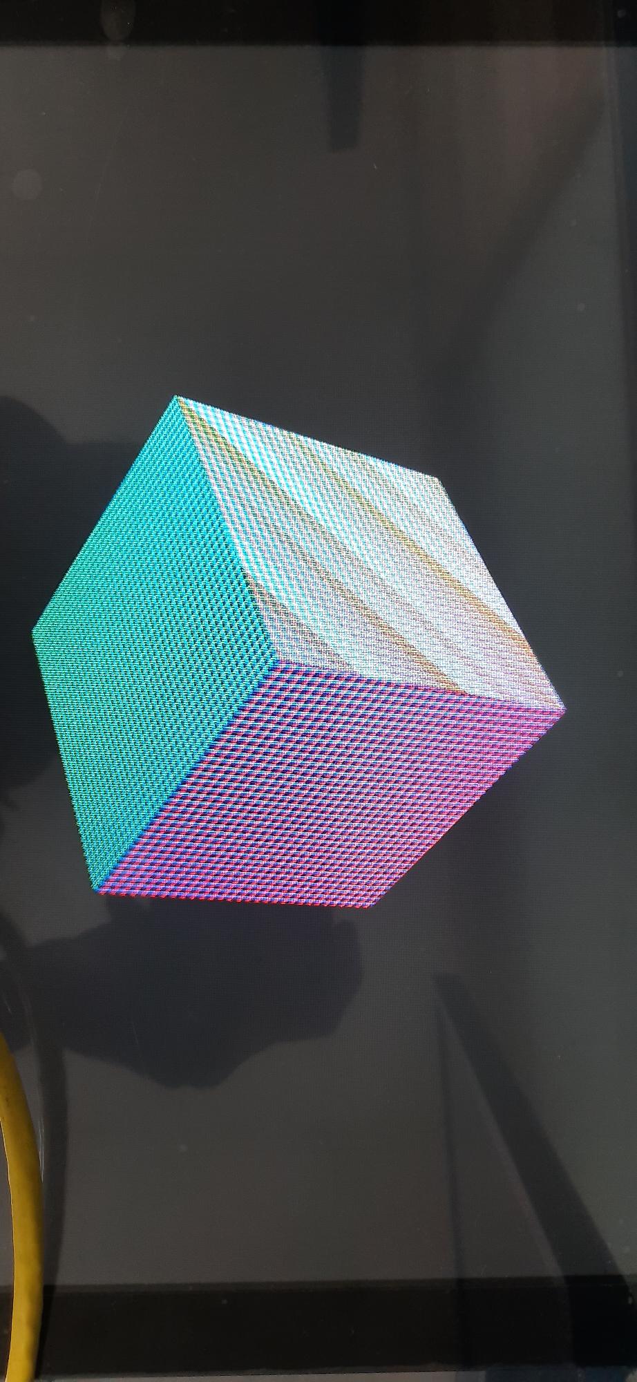

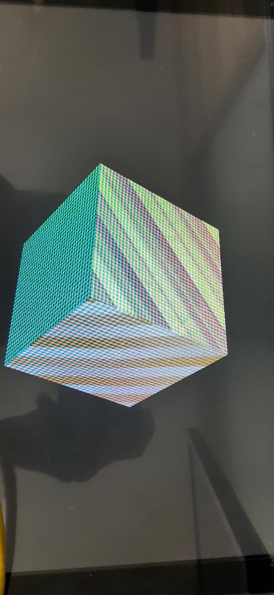

    And this is how, cube displayed.
  • Thanks! It seems like the color is messed up even with the GPU and it seems to indicate a display issue. Have you checked with your LCD vendor on the panel-timing information and data-mapping scheme?
    Krunal

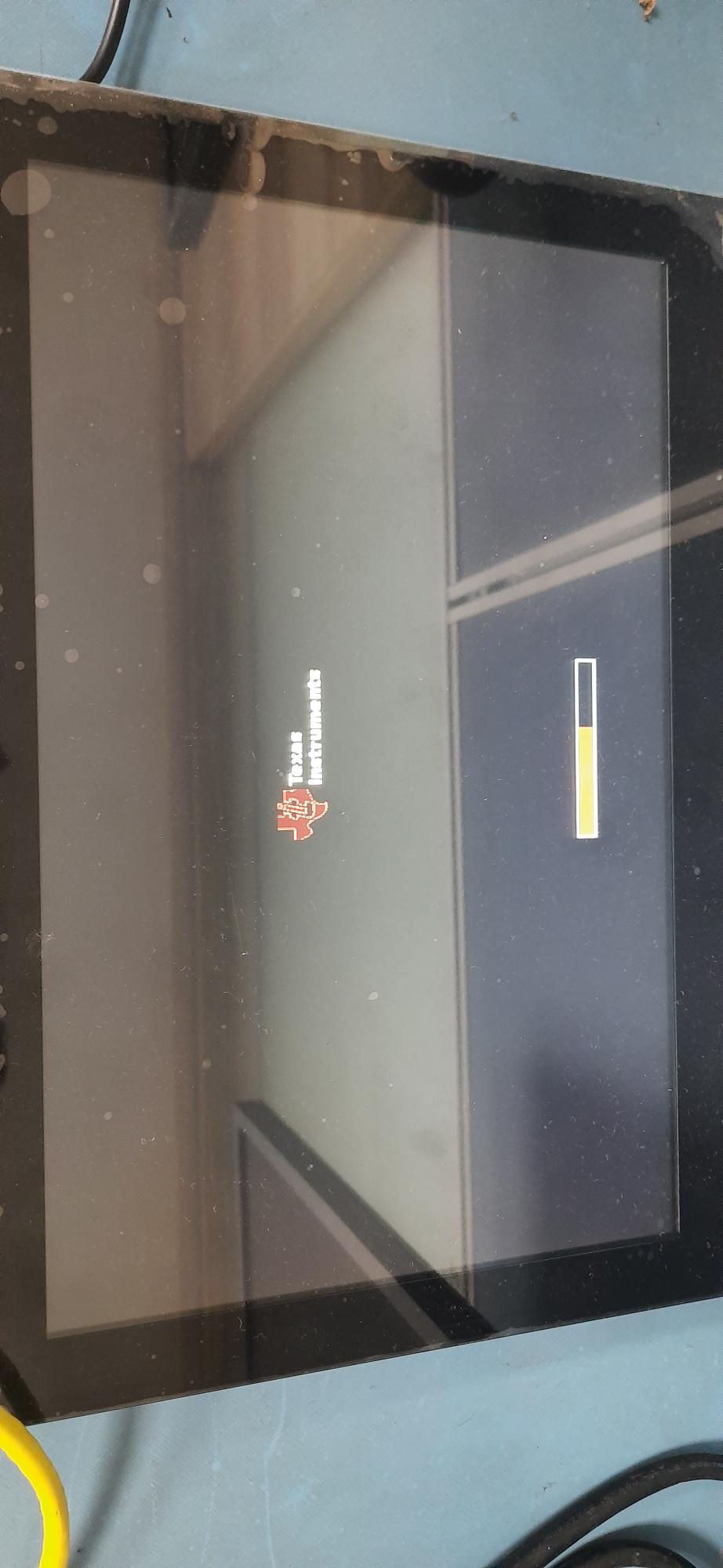

  • Hey Krunal,
    Thanks for the replay.
    Frame rate required for display is 60.0Hz. And from kmsprint command it seems that it's operating at Frame rate 65 Hz.
    another observation is that, During boot, LCD working fine. Image shown below.
    And we are using same LCD with other processors and it's working fine.
    No, the TI logo image does not look correct and just to confirm, this is a single link 1280x720 panel? I will check with our developers and get back to you on the FPS. In parallel, please check your LCD vendor on the timing parameters, data mapping and LCD configs.
    Krunal
