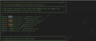

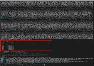

Our project used to use SDK7.3+Autosar ISOLAR7.0 on TDA4VM.
Now we want to upgrade to SDK9.0+Autosar ISOLAR7.0.
We found that several instructions in ti-cgt-armllvm_2.1.3.LTS are not supported.
Did you get a chance to look into the compiler migration guide https://software-dl.ti.com/jacinto7/esd/processor-sdk-rtos-jacinto7/08_01_00_11/exports/docs/pdk_jacinto_08_01_00_33/docs/userguide/jacinto/developer_notes/ticlang_Migrationguidelines.html#ti-arm-clang-usage-and-migration-guidelines
If not, please look into this and make sure all the guidelines has been taken cares of.
Parth

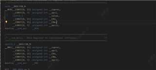

We want to know how these two functions are implemented. I can't find the implementation anywhere in the ti-cgt-arm_20.2.0.LTS compilers.
