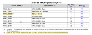

Hi expert,
At the debug stage, our customer config the MMC1_SDCD as PU and connected to SD Card detection pin, just like the EVM. But at the production stage, they do not install the SD card and use OSPI/eMMC boot. They would like to know if they can keep the MMC1_SDCD PU, or need to PD as said in the datasheet? Thanks
