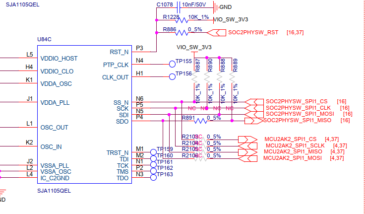

When I used spidev_test to send data, there is no data on mosi.
root@j7-evm:~# ./spidev_test -D /dev/spidev0.0 -v -H  -p 0x12345678
TX | 30 78 31 32 33 34 35 36 37 38 __ __ __ __ __ __ __ __ __ __ __ __ __ __ __ __ __ __ __ __ __ __  |0x12345678|
RX | 00 00 00 00 00 00 00 00 00 00 __ __ __ __ __ __ __ __ __ __ __ __ __ __ __ __ _
waveform1 (yellow) :cs
waveform2 (green)  :mosi
waveform3 (purple) :miso
From the waveform I can see that the CS pin is being pulled down, but there is no data (0x12345678) being sent on Mosi.
What are the possible reasons for this?

    yes,  The clk seems  to be running.   CLK runs as CS pulls down.  The Mosi has not changed and is not sure why it has been high level

    Can you share the points where you are probing? The pinmux and clock seem correct. The TX data should have come.
    Keerthy
  • HI,
     I probe the voltage of resistor R313. The oscilloscope is always at a high level.
    I am also confused why there is no TX data

    Is it possible to test the internal loopback? Connecting the TX and Rx lines?
    Keerthy
  • HI,
    I don't have the Tx/Rx shorted together. So loopback is not set.
    On the EVM we have tried with different instances & they work fine.
    https://www.ti.com/lit/pdf/sprad26
    Could you try other instances? Your settings with pinmux seem correct.
    - Keerthy
