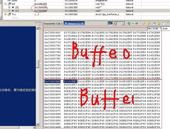

I am using C674x core in OMAP-L138 to receive data from FPGA via the peripheral uPP.
Environment:
CCS: 4.2.3.00004
DSP/BIOS: bios_5_41_10_36
pspdrivers_01_30_01
I have modified the uPP sample application of EVM to EVM communication sample for my design. Any thing about transmission is removed from the program and output channel is also removed from the BIOS .tcf configuration.
In my design, channel A is used for receiving data and uppParams.devMode has been modified to Upp_DevMode_CHAN_A_RCV in the function uppUserInit. In FPGA(which is transmitter), if the WAIT signal (which is an input signal to FPGA and an output signal from the DSP) is high, it will stop data transmission. Transmission will start again with the next word while the WAIT signal is low again.
I have modified the structure Upp_ChanParams(especially signalCfg) for my design:
1.    All START, WAIT and ENABLE signals have been enabled and the polarity of START and ENABLE signal is high and WAIT is low. However, function SIO_reclaim(uppInHandle, (Ptr *)&rcv, NULL) never returns, in other words, no data received in the buffer. With our hardware engineer’s help, we can see the control signals on another computer: WAIT signal keeps HIGH all the time, so FPGA will never send data to DSP unless WAIT signal is low.
2.    All START, WAIT and ENABLE signals have been enabled and the polarity is high(including WAIT). Data transferring completed just after the function SIO_create("/dioUppIN", SIO_INPUT, BUFSIZE, &sioAttrs) returns. We can view memory(view the buffer) to see the transferred data. Data is successive within one buffer, however, data is not successive between two buffers(the first LOOP is exceptional since no data in both buffers before the first LOOP). Which says data omission occurred between data transfer to the two buffers. We can see control signals on anoter computer: WAIT signal keeps LOW all the time, so the FPGA will send data to DSP with no stop, without concerning if DSP receives data succeed.
See the following picture:
I have seen from TI e2e community (http://e2e.ti.com/support/dsp/tms320c6000_high_performance_dsps/f/115/p/114045/404644.aspx#404644) that During normal operation in receive mode, the uPP peripheral will never assert WAIT.  The WAIT signal is an important part of the uPP protocol, but the uPP peripheral does not actually use it in receive mode. . Can this be an explanation to my problem?
What should I do to correctly use the WAIT signal and is there any alternative method for the DSP to notify the FPGA to stop data transmission??
