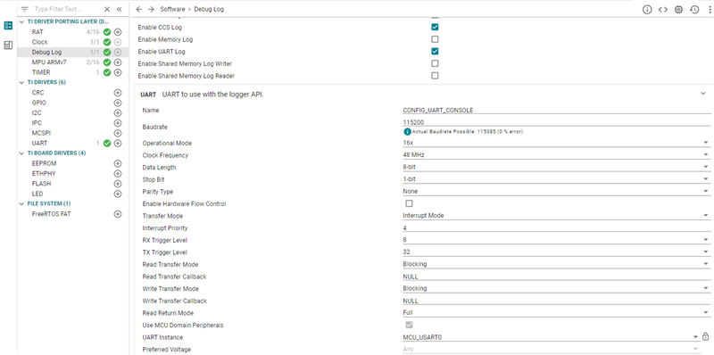

What UART port should I use for debug?

I would like to answer your question based off domains here.
So, I am listing here the list of domains here and the recommended UART port for debugging.
Also, if you use our tool SysConfig, you will find that as soon as you enable Debugging, the above mentioned UART peripherals will automatically be configured for you.
Please check the snapshot below.(It shows SysConfig for M4f Domain)

I would also like to bring your attention to the below details for SK-AM62. The information portrays different UARTs and their purpose.
MAIN_UART0: Used for Linux and U-Boot on A53
MAIN_UART1: Used for TIFS firmware
WKUP_UART0: Used for DM firmware
MCU_UART0: Used for MCU+ SDK demos and examples on M4
