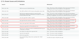

  • psdkra/sdl/sdl_docs/userguide/j721e/release_notes/j721e/release_notes_01_00_01.html
    The sdk8.6 releasenote mentioned the POK exception issue, I don't know if it is related to the current issue.
    I hope you can help me confirm this problem
