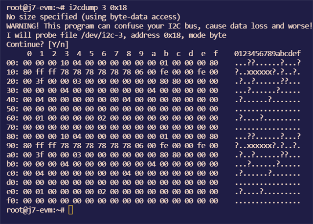

  • Hello Keerthy,
    The sound card can be detected after modifying the driver and dts.
    TDA4VM can communicate to audio chip via IIC. The driver are mounted and installed successfully.
    But after mounted successfully, there is no MCASP clock output signal and no sound when running aplay or speaker-test.
    Below is the tlv audio device dts configuration
    tlv320aic31xx: tlv320aic31xx@18 {
    compatible = "ti,tlv320aic3x";
    reg = <0x18>;
    reset-gpios = <&main_gpio0 111 GPIO_ACTIVE_HIGH>;
    /* C_AUDIO_REFCLK2 -> RGMII6_RXC (W26) */
    clocks = <&k3_clks 157 371>;
    clock-names = "scki";
    /* HSDIV3_16FFT_MAIN_4_HSDIVOUT2_CLK -> REFCLK2 */
    assigned-clocks = <&k3_clks 157 371>;
    assigned-clock-parents = <&k3_clks 157 400>;
    assigned-clock-rates = <24576000>; /* for 48KHz */
    AVDD-supply = <&vsys_3v3>;
    IOVDD-supply = <&vsys_3v3>;
    DRVDD-supply = <&vsys_3v3>;
    DVDD-supply = <&vsys_3v3>;
    Below is the driver:

    5123.tlv320aic3x.c
    Shine
  • Customer replaced the pcm3168a with simple-audio-card node, the dts file is below:
    sound0: sound@0 {
    compatible = "simple-audio-card";
    simple-audio-card,name = "tlv320aic3x-Codec";
    simple-audio-card,widgets =
    "Line", "Line Out",
    "Line", "Line In",
    "Headphone", "Headphone Jack",
    "Speaker", "speaker";
    simple-audio-card,routing =
    "Line Out", "HPLCOM",
    "Line Out", "HPRCOM",

    The sound card is mounted successfully, but it prompted below error message when playing the sound.
    davinci-mcasp 2ba0000.mcasp: Too fast reference clock (196608000)
    So the issue is focus on the mcasp or audio codec clock source. Is the dts file correct? How to resolve it?
    Rdgs
    Shine
