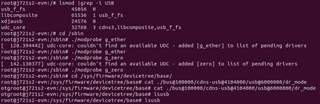

        My USB testpacket mode operation:
1)Hardware USB enters HOST state
2)modprobe g_ether, modprobe g_zero
3)  devmem2 0x06010480 w 0x000000A0;devmem2 0x06010080 w 0x00000004;devmem2 0x06010484 w 0x40000000
UDC error occurred during modprobe execution :
udc-core: couldn't find an available UDC
How to fix it   ,   thank you.

    Connect to PC , but still  the error :-core: couldn't find an available UDC

  • Hi,   USB_ID is Low,   in host mode . What config should to set ?

  • Hi,  no change in tisdk_j721s2-evm_defconfig  .
  • usb config in dts,  is it right?
    here is the defconfig about USB and UDC:

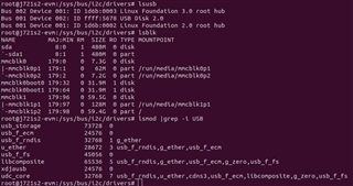

  • Hi
    I tested at my end with the prebuild images i am able to probe  g_zero
    i also could see that the usb device controller driver is UP and running
    Are you doing the test on custom board ?
    Can you share the full boot logs?

  • I can’t find the udc_core module, how to config it  in kernel?

    The first execution of 'modprobe g_ether' and 'modprobe g_zerot' prompts 'couldn't find...'. There was no prompts in the second execution. Does that mean it was executed successfully?
    Execute 'lsmod | grep -i USB' , but return nothing.
  • Hi
    if modprobe doesn't return anything that means either the driver is loaded successfully or the driver is already loaded we don't need to reload.
    i am wondering if  you USB gadget is already configured in the config then you should have driver module.
    what are the module it is showing loaded once you do the lsmod.

    After executing 'lsmod', the returned results are as follows:

        The modified result is as follows. Is it okay? When executing "modprobe g_ether" for the first time, it prompts "couldn't find ...". Is this normal?

    Have you checked on the host side whether you are device is getting detected or not ?

      Device can be detected on the host side.
  • Hi
    its working but please compare the both the defconfig which you modified with the one which come with the sdk
