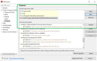

  • Hi ,
    Can you add this path "C:\ti\mcu_plus_sdk_am64x_08_06_00_48\source\commercial\industrial_comms_libs" under "Product discovery path:" of CCS as shown below.
    This should add an entry called "MCU+ SDK Industrial Communications Libraries" under "Discovered products:" as shown below. Try to import the project now and see how it behaves. Can you share the screenshot of the error message if this doesn't work?

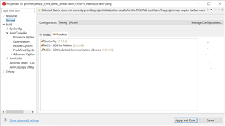

  • Setting the path slightly changes the behaviour, now I get a different error.
    See details below...
    Import failed for project 'profinet_device_demo' because its compiler definition is not available. The project does not appear to be a CCS Project. Please try importing it using the 'General > Existing Projects into Workspace' wizard.
    If I follow the suggestion of the error box, then I can open the project, but all relevant settings for building the project are missing now and compilation leads to
    gmake: *** No rule to make target 'all'. profinet_device_demo C/C++ Problem

  • Hi ,
    You can copy the image and paste it in this text box itself. I assume that using will be using the correct tool chain.
    I am unable to reproduce the error which you are facing.
    I am able to imp[ort and compile the project without any issues.
    Naresh Kumar A
  • I deleted the SDK from the file system and reinstalled it from scratch. Looks like the industrial comms folder did not install correctly on my first try - now it works.
