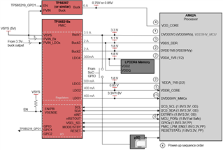

  • Hi Michael,
    Please find my feedback below and let us know if you have any questions.
    • AM62x and AM62Ax are two different processors. AM62Ax have higher VDD_CORE current requirements. Here is a link to an apps note showing the AM62Ax Maximum Current Ratings: https://www.ti.com/lit/pdf/sprada7
    • The TPS65219 PMIC can be configured to power the AM62Ax but it needs an external discrete Buck to meet the VDD_CORE current requirements. The capture below shows an example Power Delivery Network (PDN) for an application using 5V input supply and LPDDR4. TI can create a new TPS65219 orderable with a custom NVM configuration if the application meets the volume requirements or customers can use the TPS6521905 (user-programmable version).
    • The VDD_CORE voltage selection does affect the performance of 2TOPS for deep learning. At the high level, 850 MHz can provide 1.7 TOPS while 1000 MHz is required for the 2 TOPS. 1000 MHz is only supported at 0.85V VDD_CORE. Please refer to section "Operating Performance Points" in the AM62Ax data sheet for more details. Column "C7x" in the Device Speed Grades table is the deep learning engine.
    • What is the project schedule? For non-automotive applications, you can use TPS65219 or a new PMIC that is currently under development and will support multiphase configuration for higher output current.
    Brenda

  • Hi Michael,
    Below are the current PMIC solution to power AM62A for non-automotive/non-functional safety applications. Let us know if you have any questions.
    • for high volume (TPS65219 + external discrete): TI can create a new TPS65219 orderable part number with custom NVM settings to match the power diagram below. This solution integrates the 3.3V and 1.8V rails in the PMIC.
    • for low volume
      • #1 (TPS65219 + external discrete): TI provides the NVM file with the custom register settings and customer programs the TPS6521905 PMIC. This solution integrates the 3.3V and 1.8V rails in the PMIC. This is the recommended option for low volume.
      • #2 TPS6521908 + external discrete: This option requires an external power switch when using 3.3V supply or an external 3.3V Buck converter when using 5V supply. A second discrete Buck is needed to supply the CORE rails (i.e. VDD_CORE and VDDR_CORE) at 0.85V. Buck1 on the TPS6521908 will still require the input and output cap even if the rail is not used because it is enabled by default in the NVM settings.
    •   For projects that needs production devices starting in 3Q2024 or later, we recommend using the new PMIC that is currently under development.
    Brenda
