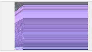

I was trying to do the flipping on LDC but when I use the matrix [-4096 0 0; 0 4096 0; 0 0 0] It is not reflecting in the output. Is the affine limited to flipping? or am missing something here.
Output Image:

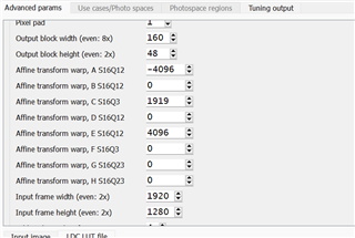

Hi Gang,
In such case it is only applying translation in the horizontal direction not the expected flipping, the generic method for flipping is [-1 0; 0 1] Right?

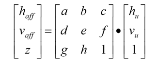

Yes, that is correct for [a,b; d, e].
But, you still need to use correct "c" and "f" values.
I have used
[-4096 0 1920
0 4096 1280
0 0 0]
[4096 0 1920
0 4096 1280
0 0 0]
[4096 0 1280
0 4096 1920
0 0 0]
[-4096 0 1280
0 4096 1920
0 0 0]
All of them, Something happens but definitely not flipping.

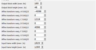

Ok, I forgot to mention the integer format of S16Q3.
1919 is the actual image width in stead of the integer/register representation.
You need to enter 15352 (=1919*8) in the field rather than 1919 (like 4096 for 1.0x).
