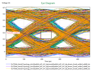

     We simulated LPDDR4 in IBIS model's slow mode, but failed at 4266 data rate(as it show as below), could you help review our board file cut in sigrity and give us some  advice (please contact xingyu-zhu@ti.com to get .spd file) ?

    From the picture not clear if the eye is captured for a read or write simulation?

  • 1. this picture shows eyes captured from a set of dq signals of write simulation.
    2. the impedance of pcb net is controlled at 40ohm.
    3. the odi&odt are both set to 40ohm and this setting provides the biggest EYE diagram.
    4. we followed the lpddr4 board design and layout guidelines to design PCB and simulation settings, except for Routing Specifications"LP4_ACRS10": Center-to-center CK to other LPDDR4 trace spacing,  we use 3W instead of 4W.
  • Agree the simulation results do not look good (fail mask requirements).  If the PCB guidelines are correctly followed, the simulation results should not look this bad.  Without additional information, it is difficult for TI to help identify areas of concern.  It is mentioned trace spacing could be an issue.  Can you confirm if the failures are a result of excessive crosstalk (due to trace spacing)?
  • We tried to simulate a few signals to eliminate the crosstalk, and confirmed that crosstalk is not the main cause. It is the driving strength in slow mode too weak that cause the bad eye results. And we have already used the best odi&odt settings, but the rise time of these buffers in slow mode are too long.

    • From the eye diagram caption snapshot  it seems using a quad die DRAM (2 rank). If so, how are setting the write ODT? One rank should have ODT and the other no ODT due to active and inactive ranks.
