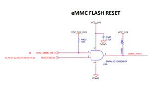

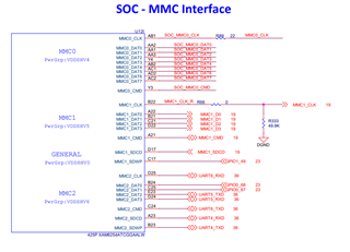

  • Can you share the schematic section that shows how the eMMC is connected to the AM62x, the power rails, and any reset signals that may be connected.
    Also there's a chance that the eMMC may ship with a different factory configuration which may impact the behavior so you may need the below to setup the eMMC for raw booting from the boot0 partition, as per Linux SDK User's Guide at https://software-dl.ti.com/processor-sdk-linux/esd/AM64X/09_00_00_03/exports/docs/linux/Foundational_Components/U-Boot/UG-Memory.html#booting-tiboot3-bin-tispl-bin-and-u-boot-img-from-emmc-boot-partition-for-k3-class-of-socs
    => mmc partconf 0 1 1 1
    => mmc bootbus 0 2 0 0
    Regards, Andreas
    This is our schematic about emmc.
    And we need boot from UDA, then dont test boot0 part.

  • Hi Fox,
    I looked over the schematic extract I don't see any immediate issue but I've asked our HW expert to double-check.
    In the meantime can you please try one more experiment with disabling the eMMC high-speed mode as shown below:

    Your Kernel logs indicate a loot of MMC related low-level communication errors, pointing to a HW-related issue of sorts.
    As indicated earlier I've also discussed your schematic with our eMMC HW expert Paul. Here is what he had to say:
    We recommend a pull-down on clock to hold the eMMC device CLK input in a valid logic state until our IOs are configured.  It appears they have one on MMC1_CLK, but not one on MMC0_CLK.  The eMMC device CLK input would be floating until our IOs are initialized.  This may allow the eMMC device to enter a bad state that doesn’t recover.
    That is the only schematic issue I spotted.  We should ask if their PCB trace delay are within the limits defined in the datasheet.
    Perhaps a non-optimum PCB trace layout that cause signal integrity issues and the Kingston eMMC device may be more sensitive to signal quality issues.
    Regards, Andreas

    Both I ask HW to add a pull-down resistance on MMC0_CLK ,but no help.

    From a hardware debug perspective, it is not possible to measure the signal timing relationships on the PCB to confirm timing margin in the read path since the appropriate delays are introduced inside the AM62x device during tuning. The write path uses fixed timing delays and we know the AM62x device is compliant to the eMMC standard as long as the PCB traces do not exceed the delays defined in the datasheet.
    The intermittent nature of the problem may be related to a signal integrity issue, which is highlighted by some sensitivity in the Kinston device.
    Based on the information provided above, it is not clear how I can help from the hardware perspective.
