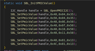

  • Hi Renf,
    Can you share the PMIC adjustment change? Can you try without that?
    Are you reducing the voltage or increasing the voltage? Also where is the code change done? Is it SBL or SPL?
    Keerthy
    This is PMIC adjustment.
    SBL would be stuck running during BL31/BL32/linux initialization memory without adding voltage to boost PMIC,SPL does not have this problem
  • Renf,
    This is custom board change. So can you make sure if both SPL and SBL are setting the same voltages?
    Keerthy
    SPL is the pmic default voltage
    A72 Why isn't there any abnormal print information, which cuts off the power What else is possible
  • Renf,
    Since a72 cannot be connected to debugger it will be harder. May I know the voltage bump done in SBL can it be increased further?
    Keerthy
    If I remember correctly, the maximum should not exceed 1 V, so I should have increased to the maximum, but the effect is still the same.
  • Hi Renf,
    What is the VDD_CORE voltage?
    - Keerthy
    VDD_CORE is 0.8v,it's no adjustment.
