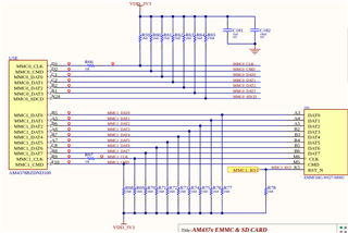

We have an am437x board running linux. The linux kernel was compiled using the 5.10.y branch from the ti-linux-kernel repo.
We can copy files to the emmc over ssh using scp. But copying files from mmc0 (sdcard) leads to hw timeout and then to kernel panic.
Since uboot can read uImage and rootfs from sdcard, we think that the issue is on the linux kernel driver.
Attached are the boot-up logs, kernel config, dts file and schematic.
Can you see any errors on the dts files or kernel config?

	sdcard_pins_default: sdcard_pins_default {
		pinctrl-single,pins = <
			AM4372_IOPAD(0x900, PIN_INPUT | MUX_MODE0) /* (D1) mmc0_clk.mmc0_clk */
			AM4372_IOPAD(0x904, PIN_INPUT | MUX_MODE0) /* (D2) mmc0_cmd.mmc0_cmd */
			AM4372_IOPAD(0x8fc, PIN_INPUT | MUX_MODE0) /* (C1) mmc0_dat0.mmc0_dat0 */
			AM4372_IOPAD(0x8f8, PIN_INPUT | MUX_MODE0) /* (C2) mmc0_dat1.mmc0_dat1 */
			AM4372_IOPAD(0x8f4, PIN_INPUT | MUX_MODE0) /* (B2) mmc0_dat2.mmc0_dat2 */
			AM4372_IOPAD(0x8f0, PIN_INPUT | MUX_MODE0) /* (B1) mmc0_dat3.mmc0_dat3 */
			AM4372_IOPAD(0x990, PIN_INPUT | MUX_MODE4) /* (N24) mcasp0_aclkx.mmc0_sdcd */
	emmc_pins_default: emmc_pins_default {
			AM4372_IOPAD(0x880, PIN_INPUT | MUX_MODE2) /* (B9) gpmc_csn1.mmc1_clk */
			AM4372_IOPAD(0x884, PIN_INPUT | MUX_MODE2) /* (F10) gpmc_csn2.mmc1_cmd */
			AM4372_IOPAD(0x800, PIN_INPUT | MUX_MODE1) /* (B5) gpmc_ad0.mmc1_dat0 */
			AM4372_IOPAD(0x804, PIN_INPUT | MUX_MODE1) /* (A5) gpmc_ad1.mmc1_dat1 */
			AM4372_IOPAD(0x808, PIN_INPUT | MUX_MODE1) /* (B6) gpmc_ad2.mmc1_dat2 */
			AM4372_IOPAD(0x80c, PIN_INPUT | MUX_MODE1) /* (A6) gpmc_ad3.mmc1_dat3 */
			AM4372_IOPAD(0x810, PIN_INPUT | MUX_MODE1) /* (B7) gpmc_ad4.mmc1_dat4 */
			AM4372_IOPAD(0x814, PIN_INPUT | MUX_MODE1) /* (A7) gpmc_ad5.mmc1_dat5 */
			AM4372_IOPAD(0x818, PIN_INPUT | MUX_MODE1) /* (C8) gpmc_ad6.mmc1_dat6 */
			AM4372_IOPAD(0x81c, PIN_INPUT | MUX_MODE1) /* (B8) gpmc_ad7.mmc1_dat7 */
&mmc1 {
    status = "okay";
    vmmc-supply = <&evm_v3_3d>;
    bus-width = <4>;
    pinctrl-names = "default";
    pinctrl-0 = <&sdcard_pins_default>;
/* eMMC sits on mmc2 */
&mmc2 {
    status = "okay";
    bus-width = <8>;
    pinctrl-0 = <&emmc_pins_default>;
    non-removable;
