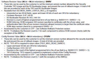

Simply remove them and it will do the trick.
Why did I remove these keys specifically ? Well, the OTP Keywriter User Guide specifies that these keys shouldn't be programmed in the first place (page 6 in bold).
Also before removing them the generated primary_cert.bin generated was only slightly bigger than the 5.4 kB limit. Removing these 3 keys will make the certificate fall at 5.3 kB.
I did a lot of trial and error, and observed that the issue was coming from the 5.4 kB limit, there might be a deeper explanation to that, but again, these are my observations.
