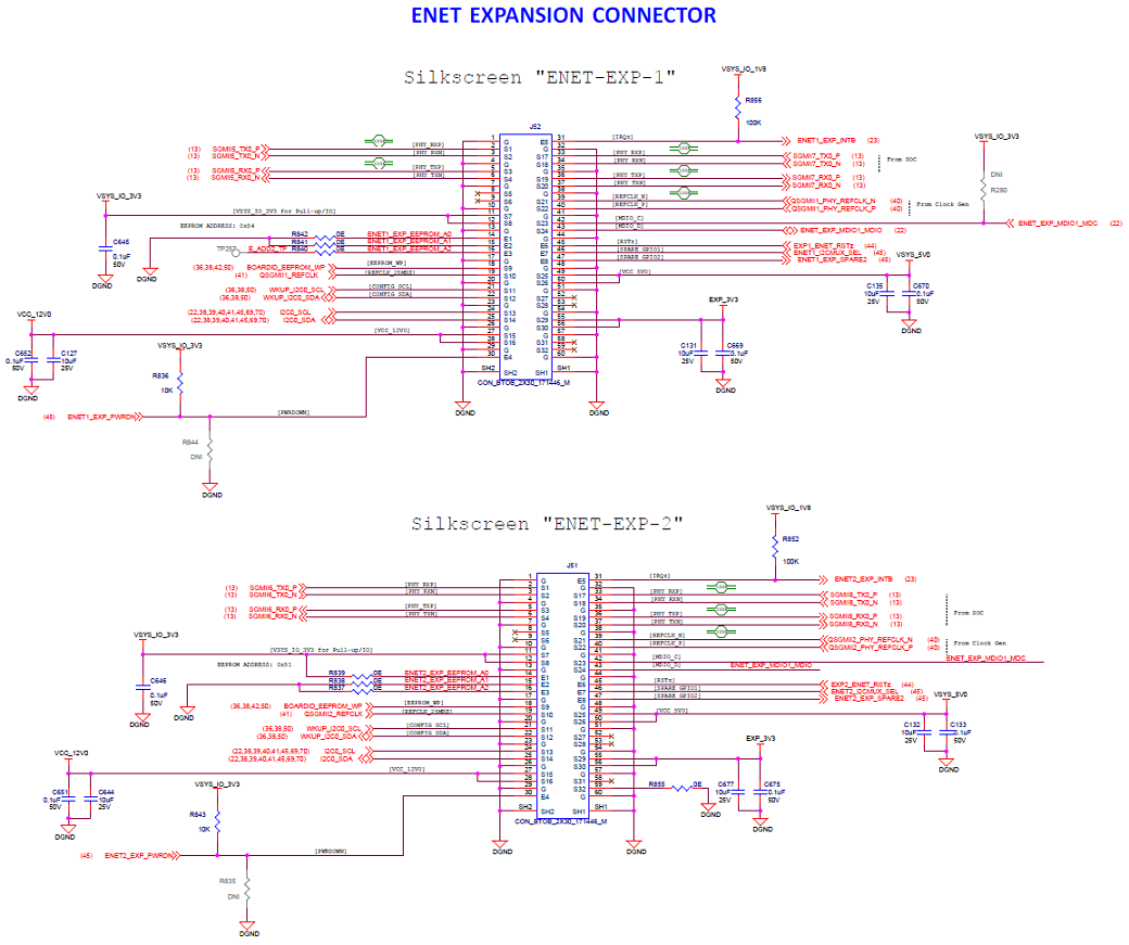

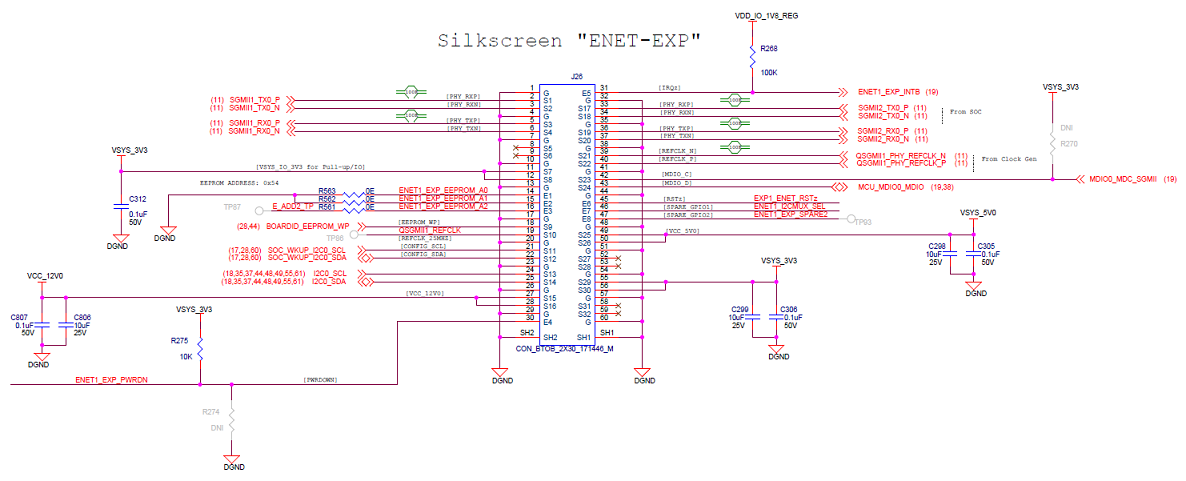

Does SK-AM69 support J721EXENETXPANEVM?
If so, does the latest Processor SDK Linux support SK-AM69 with J721EXENETXPANEVM?
The expansion connectors seem to be compatible with each other. SGMII2 is used via an expansion connector.
SK-AM69 side
J721EXENETXPANEVM side

  • Hi Daisuke,
    This is something that is compatible via the ENET header but is not supported out of the box. Please reference the SK-AM69 User Guide: https://www.ti.com/lit/pdf/spruj70

  • Hi Fabiana-san,
    Thank you for you reply.
    J784S4XG01EVM with J721EXENETXPANEVM will be supported in Processor SDK Linux. The DTS file "k3-j784s4-quad-port-eth1-exp.dts" seems to support it.
    J784S4XG01EVM has two expansion connectors, and it seems that SGMII7 or SGMII8 can be used with J721EXENETXPANEVM via the expansion connector.
    Could you please tell me how to modify Processor SDK Linux to use SK-AM69 with J721EXENETXPANEVM?
    Does it only change the SGMII port used for SK-AM69?
    Or is it difficult because different boards have different traces and the SerDes configuration needs to be changed?

  • Hello Daisuke,
    Yes.
    Yes, at a time, you can use one of the two expansion connector to connect to quad Ethernet expansion board.
    The support for SK-AM69 to use with J721EXENETXPANEVM is not validated and supported by the Processor SDK Linux. We will check internally and get back to you with answers to your query.
    Thanks.
