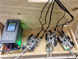

    We are currently running a long test run and will provide an update on any progress made. The setup we are currently using:
    • Connected PLC with three ICE_AM3359 in daisy chain network.
    • Set the IO cycle time to 1ms to reproduce the problem faster.

    As you suggest, we will also do a long time test with one Siemens S7-1515 PLC and three ICEv2 boards.
    We will set the IO cycle time to 1ms.
    For this test we will use the latest version of both the TMG Profinet stack and TI Profinet example application.

    The test with the S7-1515 PLC and the three ICEv2 DUT:s connected in daisy-chain is up and running. IO cycle time is set to 1ms.
  • Dear Aravindh,
    We have also been running similar test on our side, currently it has been around 40 hours since the test begun and we have not observed any disconnection issues.

    The test has been run for approximately 4 days (96 h). There has been no Profinet communication failure on any of the three ICEv2 DUT:s.
    I think we can conclude that the communication is stable and therefore, there is no bug in the PRU firmware (we use the same PRU firmware version in our product). But there are differences in the HW between the ICEv2 and our custom board (PFEA122). The PFEA122 uses the DP83822 Ethernet PHY (ICEv2 uses TLK110) and a 25MHz oscillator (ICEv2 uses 24MHz).
