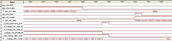

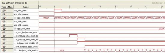

  • now I debug the upp with FPGA, upp transfer 2k data to FPGA,then feedback to upp.the FPGA signals seems right,but the upp receive a bad data at the beginning,all other data(s) are right. Incording to the diagram, the first data I should receive is 0x5A5AFF00,but is 0 instead.
