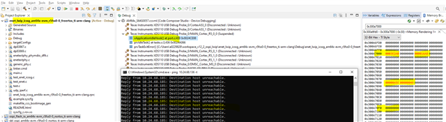

    We made the following experiment: We got ENET/LWIP/ICSSG application software running, and 'ping [EVM-IP] -i.001 -f' works perfectly without any frame loss.
    Then we halt the host processor by debugger. From that moment ping reports requests not being answered (as expected).
    We can view the PA statistics in the debugger by displaying the shared memory contents starting at address 0x300a7000 in the host processor's address space). We actually see the PA statistics counter for received bytes and received frames continueously incrementing (for far more than 10.000 frames after halting the host processor). Exactly what we expect.
    However, the counter at byte offset 0xf0, this is NRT_HOST_EGRESS_Q_PRE_OVERFLOW_PASTATID, remains at count zero, although - according to my understanding of your post - many overflows of the MSMC queue must have occurred after halting the host processor!
    Do you have any explanation for this behaviour?
    In our opinion an increment of an overflow counter would be a perfect and completely sufficient indication for overflows, but only when we can rely upon...
    Best regards, Sven

    To reproduce the issue you are seeing on my setup. I build enet_lwip_icssg example. Load the binary and pause the r5f_0_0 core.
    You are expecting 0x300a70f0 to be non-zero as host is unreachable for ping response. correct?
    Best Regards
    Ashwani
  • Yes, exactly! The display of my debugger is nearly identical to yours...
