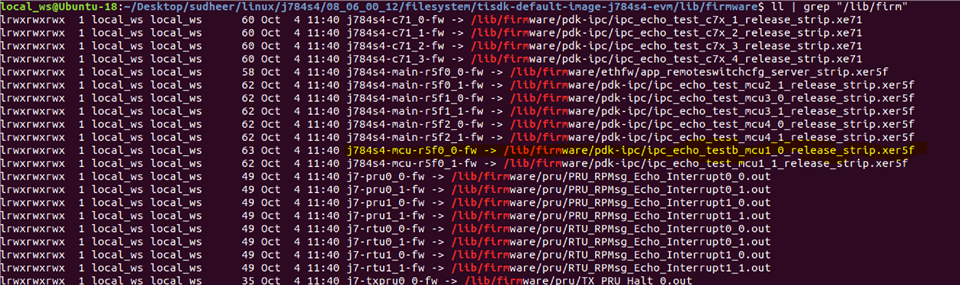

  • j784s4-mcu1_0-fw OR j7-main-r5f1_0-fw : which is the correct one for mcu1_0? so that the bootloader loads it?
    j784s4-main1_0-fw OR j7-main-rf1_0-fw : is this naming convention legal, as mcu1_0 belongs to Main?
    You no need to pass main or mcu in firmware name.
    please refer to below image from default file system of Linux SDK of TDA4VH.
    j784s4-mcu-r5f0_0-fw : is correct one for mcu1_0.
    If you want to change the MCU1_0 firmware, you have to soft link your firmware to above highlighted one. Also, need to pass the same DM variable in make command as you pointed above for creating SPL image.
    As I have mentioned above, "mcu in soft link of file name indicated MCU domain usually mcu1_0, mcu1_1 cores."
