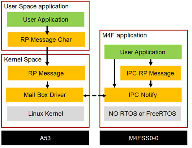

  • Hi Vic,
    These two pages on Linux Academy for AM62x answers your questions:
    Booting Remote Cores: https://dev.ti.com/tirex/explore/node?node=A__AISILbMWZ4d84U2oSmXcdA__linux_academy_am62x__XaWts8R__LATEST
    IPC Example: https://dev.ti.com/tirex/explore/node?node=A__ACKtJpWz8b53RwT-PJ4qmA__linux_academy_am62x__XaWts8R__LATEST
    Does A53 require loading a specific DTS file (Processor SDK Linux for AM62x09_00_00_03)? Or is there a need for any modifications?
    Answer: The Linux device tree include information about which firmware to load into the remote cores. "Booting Remote Cores" page linked earlier provides more details.
    Are there more formal documentation or information available to understand the differences or usage scenarios?
    Question:  Are there more formal documentation or information available to understand the differences or usage scenarios?
    Answer: I suggest you start with the two pages above.
    Please, let me know of any clarifying questions after you have ran the out of box demos.
    Qutaiba

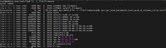

  • Hi Qutaiba
    The SDK version I am using is Processor SDK Linux for AM62x09_00_00_03. I am using a ompiled version of the image.
    May I ask if ipc_echo_baremetal_test_mcu2_0_release_strip.xer5f was generated through Code Composer Studio?
    Is it possible to modify the functionality of the M4F Core arbitrarily when booting Remote Cores?
    Booting Remote Conterl:
    IPC Example:
  • Hi Vic,
    Before starting the remote core, you have to link the appropriate firmware. See this example:
    root@am62axx-evm:~# cd /lib/firmware/
    root@am62axx-evm:/lib/firmware# ln -sf /lib/firmware/ti-ipc/am62axx/ipc_echo_test_mcu2_0_release_strip.xer5f am62a-mcu-r5f0_0-fw
    Note that it is important to CD to /lib/firmware when you link the firmware.
    Then reboot the EVM and then run the remote core:
    root@am62xx-evm:~# echo start > /sys/class/remoteproc/remoteproc0/state
    Then try the already compiled IPC example:
    root@am62axx-evm:/opt/edgeai-gst-apps# rpmsg_char_simple -r 0 -n 3
    Created endpt device rpmsg-char-0-1502, fd = 4 port = 1025
    Exchanging 3 messages with rpmsg device ti.ipc4.ping-pong on rproc id 0 ...
    Sending message #0: hello there 0!
    Receiving message #0: hello there 0!
    Sending message #1: hello there 1!
    Receiving message #1: hello there 1!
    Sending message #2: hello there 2!
    Receiving message #2: hello there 2!
    Qutaiba

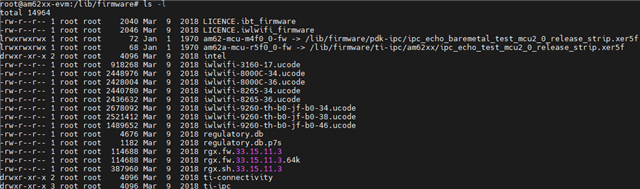

  • Hi Qutaiba
    I Provided a screenshot of my running results.
    Provide running photos:

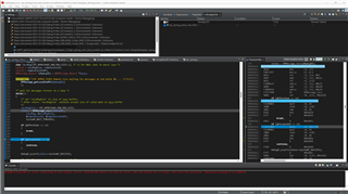

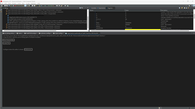

  • HI Qutaiba Saleh
    The issue has been fixed.
    I am currently in the process of verifying it in Code Composer Studio Debug.
    As shown in the screenshot, Trace Debug M4F requires the TaskP_freertos.c file. I have checked the SDK installation directory and couldn't find this file.
    Currently, we are discussing two possible approaches:
    1. Verification of Trace Debug M4F in the Code Composer Studio development environment for I/O.
    2. Debugging the collaboration between A53 and M4F.
    Can't find a source file at "/home/gtbldadm/nightlybuilds/repo_manifests/scripts/jenkins/mcu_plus_sdk_am62x_09_00_00_19/source/kernel/freertos/dpl/common/TaskP_freertos.c"

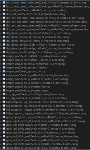

    In AM62X devices, the software package is divided into two packages: one is the processor SDK and the other is the MCU+SDK.
    The processor SDK mostly belongs to Linux, and you can experiment on the A53 core.
    MCU+SDK belongs to RTOS/NO RTOS, and you can experiment on R5F and M4F cores.

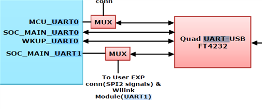

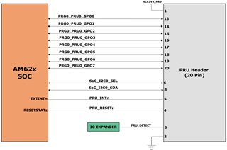

    See the below image. WKUP_UART0 is used in the USB to UART bridge, and please try to download the HW schematic of the AM62X and check more
    details about headers, which are the pins are going to headers. I will share FAQ shortly .

    Thanks for sharing end-product details. This device can be fit in to achieve your requirements.
    Its main role is to achieve low-power external I/O wake-up, specifically WKUP_UART0.
    Based on the above information, you are mostly running the UART application and controlling GPIO's on R5F .So, you can able to get low power .
