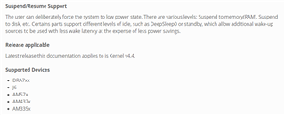

Hi
We are evaluating the AM57X with the following environment.
  Board : TMDSEVM572X
  SDK : PROCESSOR-SDK-LINUX-AM57X-06.03.00.106
            Download am57xx-evm-linux-06.03.00.106.img.zip and write this image to the micro SD card.
We want to use suspend and resume.
We tried as follows.
Set "no_console_suspend" in u-boot.
=> setenv optargs no_console_suspend
Check that the cmd line contains "no_console_suspend".
root@am57xx-evm:~# cat /proc/cmdline
console=ttyS2,115200n8 no_console_suspend root=PARTUUID=351f25a0-02 rw rootfstype=ext4 rootwait
Test as below.
However, suspend is not completed.
