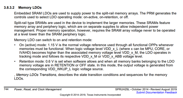

  • Hello Kanae,
    I looked into the AM335x, AM437x and AM572X and found the below description.
    I guess the SRAMNWA is SRAM network array.
    AM335x
    AM572x
    Sreenivasa

  • Hello Kanae,
    Thank you for the inputs.
    If SRAMNWA is an SRAM network array as you pointed out, does it mean that SRAMNWA specifically refers to the "Memory bank" in the above figure?
    Please note that i am interpreting the datasheet (additionally referring AM335x and AM572x) to answer and based on the description i believe this is the memory section.
    In that case, when bit 1 of PRCM_PRM_LDO_SRAM_CORE_SETUP register: abboff_act_export is set to "1", SRAMNWA is supplied from VDDAR,
    but does "varray" in the above figure mean "VDDAR"?
    I do not understand it well, so please explain in detail.
    I assume VDDS is the external 1.8V input and VDDAR is the SRM LDO output. I guess Varray is the selected output and could be VDDS or VDDAR.

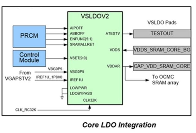

    The datasheet "5.11.1.2 IO and Analog Voltage Decoupling Capacitors" states that
    VDDS_SRAM_CORE_BG supplies power to the internal LDO for SRAM.
    In addition, "5.11.2 Output Capacitors" shows a block diagram of the internal LDOs as follows.
    Based on the above, is the understanding of the power supply to SRAMNWA correct as follows?
    Also, are the voltages used by SRAMNWA different for VDDS and VDDAR?
    For PRCM_PRM_LDO_SRAM_MPU_SETUP register,
    VDDS: The power supplied to the VDDS pin from the outside is directly used for SRAMNWA
    *Is the voltage 1.8V used as it is? Or is VDDS also stepped down by internal LDO?
    VDDAR: Use the external power supply to the VDDS_SRAM_MPU_BB pin for SRAMNWA
    via the internal LDO.
    *Is the voltage stepped down to some V to solve the LDO?

    Please search for VSLDO in the TRM.
    Refer below input i received from the expert:
    I don’t think you would need to change it from the efuse value except for debug.
    I guess i may not have any additional inputs.
    Sreenivasa

  • Hello Kanae,
    Thank you.
    1. Each LDO Integration figure could not be found in TRM.
    Which document did you refer to?
    We do not have this in the TRM. This is the integration document.

  • Hi Sreenivasa,
    Thank you for your reply!
    I understand that the above figures are provided from an unpublished TI internal integration document.

  • Hello Kanae,
    For the VDDAR there are trim registers and so i guess the input is being regulated
    Is it correct to understand that the voltage used to supply power to SRAMNWA differs between VDDS and VDDAR as shown in the figure below, and that when VDDAR is selected for SRAMNWA, the voltage is stepped down by the internal LDO?
    Regarding the VDDS i guess this is using the external 1.8V applied.
    Sreenivasa
  • Hi Sreenivasa,
    Thank you for your support!
    My customer does not want to change the default register values,
    so I don't think it is a problem.
    I appreciate your clarification of the following customer concerns.
    - VDDAR has a trim register, so the input is adjusted.
    - As for VDDS, it uses an external 1.8V.
