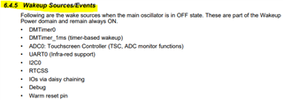

Hi experts,
My customer wants to implement Deepsleep using "PROCESSOR-SDK-LINUX-AM437X v: 06.03.00.106".
Q1:Is it possible to WakeUp with GPIO0 from Deepsleep on AM437x?
I'm confused because the descriptions are different between TRM and SDK DG.
Q2:Also, is it still support PROCESSOR-SDK-LINUX-AM437X v: 06.03.00.106 on E2E ?
  • SDK Linux Software Developer’s Guide - 3.2.4.12. Power Management - Suspend/Resume
  • TRM - 6.4.5 Wakeup Sources/Events
    (Furthermore, judging from "Table 6-31", "6.4.3.3 DeepSleep", and "28.3.3 Interrupt and Wake-up Features", it is assumed that only GPIO0 is possible.)
