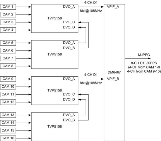

HI Anshuman,
Thanks for your reply. I have another question related to the TVP5158 and the capture driver. Is it possible to have a configuration with (4) TVP5158's in which 2 are cascaded and the output of the master is tied to channel A of a DM6467 and 2 additional are cascaded and tied to channel B of a DM6467? It would be similar to the diagram from figure 3-14 of the TVP5158 datasheet but I would like to have 4 images at D1 available on each channel of the DM6467. Then, would it be possible to perform an MJPEG compression at 30FPS on the 8 cameras and stream them over Ethernet?
Thanks for your help.
Travis
