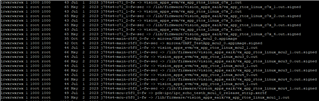

I have compiled using "
ti-processor-sdk-rtos-j784s4-evm-09_00_00_02.tar.gz  — 1432019 K
the demo app Uart_TestApp_Freertos for mcu2_0, and placed in the sd card location as seen bellow:
On a separate thread: TDA4VH-Q1: signing rtos binaries for HS devices - Processors forum - Processors - TI E2E support forums
I found out which binary to place in the lib location.
