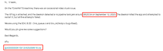

hi,ti team,
On the TDA4VM T5 machine, there was an occasional video stuck issue.
The r5f log is attached, and the daemon detected a vx pipeline task jam around 08:20:34 on September 12, 2023. The daemon killed the app and attempted to restart it, but all five attempts failed.
We are using the SDK: 8.00(tivx_queue.c and dss_m2mApi.c bugs fixed).
Would you pls give me some suggestions?
xftu
@40000000610b12c92bdb8618.zip
    your one of the issue is due to below error. How many instances of DSS M2M driver are you using ? It seems that it has run out of all the instances?
    How are you killing the application?
    2023-09-12_08:20:46.94165 [MCU2_0] 351.177253 s: src/drv/m2m/dss_m2mApi.c @ Line 388:
    2023-09-12_08:20:46.94166 [MCU2_0] 351.177301 s: No more instances to allocate...
    2023-09-12_08:20:46.94166 [MCU2_0] 351.177333 s: src/fvid2_drvMgr.c @ Line 759:
    2023-09-12_08:20:46.94166 [MCU2_0] 351.177355 s: Driver create failed!!
    2023-09-12_08:20:46.94166 [MCU2_0] 351.177389 s: VX_ZONE_ERROR:[tivxDisplayM2MDrvCfg:907] : Display M2M Create Failed!!!
    2023-09-12_08:20:46.94166 [MCU2_0] 351.177433 s: VX_ZONE_ERROR:[tivxDisplayM2MCreate:380] Unable to allocate local memory

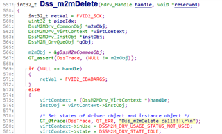

  • Hi, eftu,
    TIVX_TARGET_DISPLAY_M2M1 and TIVX_TARGET_DISPLAY_M2M2 are not the instances of this node. They are essentially different targets. How many nodes are you creating for these targets? Are these nodes replicated? If they are, how many are they replicated?
    Can you please print some messages in the DSS M2M delete API and see if it is getting called, when killing the application?
    Brijesh
  • hi Brijesh,
    Four nodes are creating for target TIVX_TARGET_DISPLAY_M2M1 and three of of them are replicated. One node is creating for target TIVX_TARGET_DISPLAY_M2M2.
     print "Dss_m2mDelete call!!!" messages in the DSS M2M delete API,  it is getting called, when killing the application.

    xftu
  • Hi xftu,
    But this is getting called only 5 times But looks like you are creating many instances of this nodes, 3 replicated n-times + 1 + 1. It should be called for even every replicated node. If this delete is not called for every opened node, the next time, it can potentially run out of handles. Please make sure to close all open handles.
    Brijesh

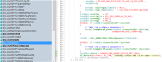

  • Hi xftu,
    Can you also check if tivxDispM2mFreeObject API is getting called in tiovx\kernels_j7\hwa\display_m2m\vx_display_m2m_target.c file? This is also important, as it frees up the TIOVX objects.
    Brijesh
  • Hi Brijesh,
    tivxDispM2mFreeObject API is getting called too.

    Can you please add some print in Dss_m2mDelete API in the DSS driver and see if below statement is executed when you are calling delete?
    instObj->inUse = DSSM2M_DRV_USAGE_STATUS_NOT_USED;
    Brijesh
  • Hi Brijesh,
    Below statement is executed.

    [220101-01:02:16.252] [MCU2_0] 3738.365181 s: src/drv/m2m/dss_m2mApi.c @ Line 579:
    [220101-01:02:16.252] [MCU2_0] 3738.365208 s: Dss_m2mDelete call!!!

    [220101-01:02:16.253] [MCU2_0] 3738.368457 s: src/drv/m2m/dss_m2mApi.c @ Line 638:
    [220101-01:02:16.253] [MCU2_0] 3738.368487 s: instObj->inUse set to no used!!!
    [220101-01:02:16.253] [MCU2_0] 3738.368533 s: VX_ZONE_ERROR:[tivxDispM2mFreeObject:1117] tivxDispM2mFreeObject call!!!
