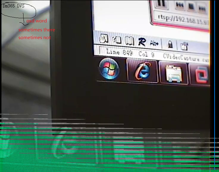

Hi all,
I have two problem for help(Dvsdk version: 4_02_00_06 ):
1, I modified yuv422 image data for osd word, then put it as VIDENC1_process input buffer. when h264 encoding is complete,i use this input buffer data to display on led screen. this time, the osd word sometimes there sometimes not,I think VIDENC1_process should not modify the input buffer data,i sure i modified all the video image,but the osd word is still flick on screen. if i modiy image data after VIDENC1_process call, the osd word is normal display.what is wrong?
2, video display normal on screen,but problem in vlc decode display.
the video is normal display on screen, when after h264 encode, take h264 stream to vlc decoder to decode and display, the above is the effect picture.These green bar also sometimes there, sometimes disappear.
