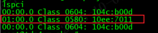

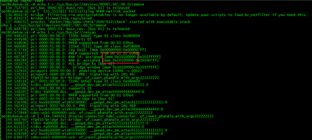

Please help analyze a system exception and how to solve it.

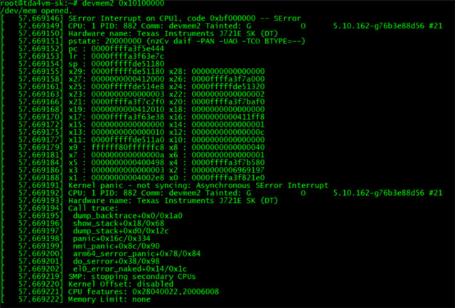

We have a board that uses TDA4VM as PCIE RC and FPGA as EP, and uses echo 1 > /sys/bus/pci/rescan to detect ep devices.
And access the BAR address through devmem2, but a system exception occurred.
Thank you.
  • I refer to this issue:e2e.ti.com/.../4668074
    If 0xbf000000 is filtered out, no exception occurs that reads or writes on the BAR of the EP. However, the written data does not take effect, and the EP node cannot receive read or write signals.
    SDK version,08.06.01
    root@tda4vm-sk:~# devmem2 0x10100000 w 1
    /dev/mem opened.
    Memory mapped at address 0xffffa8f61000.
    Read at address  0x10100000 (0xffffa8f61000): 0x00000000
    Write at address 0x10100000 (0xffffa8f61000): 0x00000001, readback 0x00000001
    /dev/mem opened.
    Memory mapped at address 0xffff9e8ce000.
    Read at address  0x10100000 (0xffff9e8ce000): 0x00000000
  • Hi Ljc,
    So far, I have not been able to reproduce the issue on my setup.
    Attached are my logs for comparison in which I have TDA4VM as the RC and TDA4VL as an EP:

    It is strange that a bus error pops up when accessing BAR0. I will be trying out some other experiments to see if I can reproduce these errors on my setup, but it might be that this is an issue on the FPGA-side, in which whatever address these BARs are mapped to are non-writable or protected from writes somehow. The reason being, the E2E you referenced is a fix for ignoring "UR responses (aka, unsupported request)" triggering a system abort when it should not trigger a system abort. If the patch made the error go away, most likely an UR response was being generated from the FPGA-side.
    So my suggestion is to see if the FPGA memory location this BAR is mapped to can be accessed or not.
    Takuma
