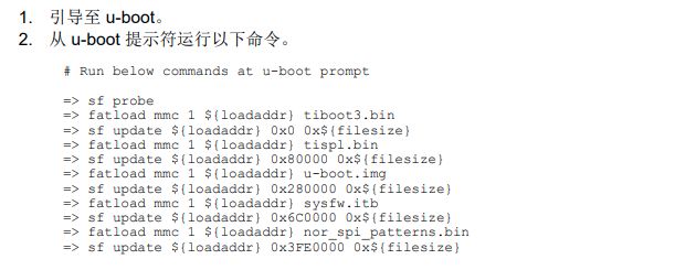

Followed the link to create tisdk-tiny-image.img(https://www.ti.com/lit/an/spracy5/spracy5.pdf?ts=1694071398294&ref_url=https%253A%252F%252Fwww.google.com%252F),
The files and addresses burned in flash are as follows:
And then burned the above tiny-image at 0x800000:

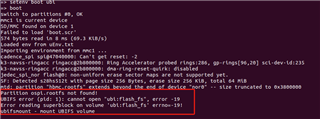

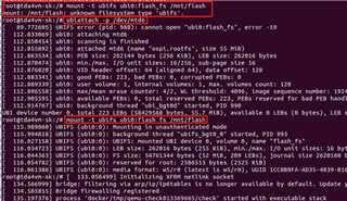

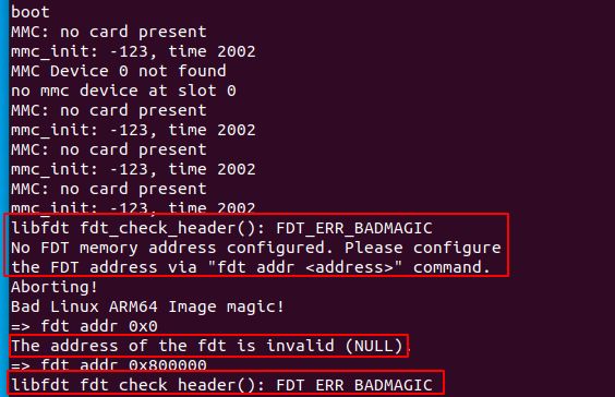

During the uboot phase, using the boot command to boot the kernel will report the following error:
As the document stated, U-boot.img will boot to SD card.
The customer would like to know how to switch the u-boot.img to ospi? Or could you help share is there any other way to resolve the above error? Thanks.
